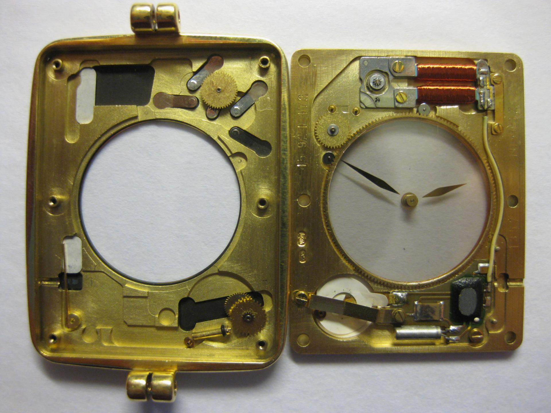

Da li neko moze da mi objasni kako funkcionisu kazaljke na ovom satu?
http://images.tapatalk-cdn.com/16/01...9da94dbeb9.jpg
Nasao sam ovo ali ne razumem najbolje "If this is the first time you are seeing this complication – let us keep it simple and call it as such – you may be wondering how the Cartier mysterious hours works. The solution, once you are told, seems blatantly straight-forward: the watch has its hands fitted to two separate, transparent sapphire discs which have teethed edges; the movement drives these discs as it would normally move the hands – and voilà, a floating effect is achieved."
Verovatno je minutna (velika) kazaljka ljepljena za gornje staklo koje je rubno uzubljeno u zubcanik (sto se ne vidi ) a satna (mala) je upresana u donje staklo. I isto uzubljeno rubno. Po meni se okrecu ta dva stakla...

Tako je, providna uzupčena stakla/pleksiglas diskovi. Npr. Omega Magique je to imala i kada se otvori, mehanizam izgleda ovako:
Prilog 119293
E sad, kapiram da je kod mehaničkih satova on znatno komplikovaniji, ali je princip rada isti.
