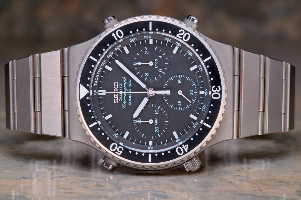

The above, by way of introduction, is intended to provide at least some slim historical context to the present Seiko chronograph, which notably predates both Swiss efforts. Introduced in 1983, Seiko's 7A28 (and related) movements were intended as their best efforts in designing quartz-controlled chronographs. As with the JLC and Piguet movements, this now seems rather quaint, if not misguided, but at the time these held real horological significance. While the Swiss firms were naturally trying to preserve their vital traditions from the seemingly-past mechanical age, Seiko dove right in and produced the world's first all-analog-display quartz chronograph. Even though these watches were relatively modestly priced (about US$250), the 7A28s inside were clearly intended to be permanent movements. Most unusually, the mechanism is fully jeweled (15), uses no plastic parts, and allows for simple regulation by the user. A separate motor is provided for each indicating function, and the button at 10 o'clock temporarily stops the chronograph hands' motion as actual timing continues, providing an odd sort of "split-second" function. Best of all, while the main chrono-seconds hand moves at the typical quartz once/second, the hand within the subdial at 3 o'clock races along at a most entertaining 20 steps per second, (although it is labeled "1/10s").
My initial interest in this Seiko was as a military watch, in this case chronographs produced for the British Royal Air Force in the 1980s and 90s. During this time two very distinct models were supplied by Seiko; while the later was a perfectly ordinary watch with a disposable unjeweled movement, the original 1983 design was powered by the very sophisticated 7A28. Although only some 11,000 were issued during the ensuing decade, it was an iconic design, with a 38mm case and an especially elegant and functional dial (click for more!):

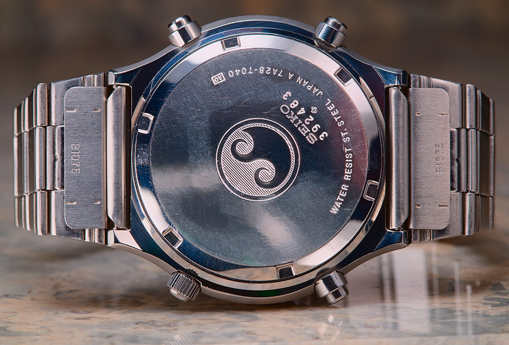

The present watch features the same excellent movement and dial arrangement, but in a handsome 40mm civilian version with a counterclockwise rotating timing bezel. The buttons at 2 and 4 o'clock are for standard chronograph start/stop and reset, while the "split" button is at 10. When fully extended, the crown stops and sets the movement; an intermediate position allows the chronograph hands to be properly zeroed (usually after changing the battery). The brushed, folded-link bracelet is...a great visual match for the matted, stainless steel case.
