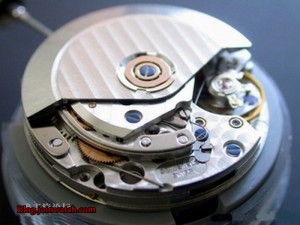

Mechanical Chronograph Movement-ETA7753
7753 is the new version of 7750. You can see these two movements are both available in watch market. The 7750 is famous for its fine chronograph movement. However, it is based the cheap chronograph movement. In designing 7750 movement, manufacturer uses some plastic parts and metal wire spring and so on. Therefore, it is not as excellent as the 2892 movement. The traditional performance of a real “excellent” movement is to achieve zero chronograph difference. Of course, some reprocessing versions of 7750 can rival with the 2892 or even more excellent. But the price is correspondingly higher.

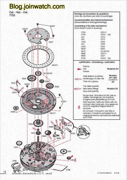

evo linka : ETA 7750 VS 7753 | Comparing the most famous ETA Chronograph movement | Latest wristwatch News

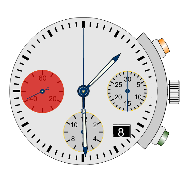

Naime - iako je osnova ista, kod 7753 podcifer za minute je u stvari premesten sa 12h na 3h. Ovo je i razlog zasto je datum sklonjen sa 3h. Pomeranje ovog podcifera je koliko znam ucinilo mehanizam nesto komplikovanijim i samim tim i skupljim i eksluzivnijim. Iako sam vidjao i pausalne ocene da je 7753 pouzdaniji, verujem da je u stvari manje pozudan od 7750.

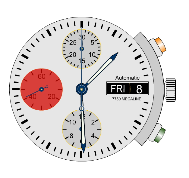

Evo da probam da docaram (igarjuci se u fotoshopu sa originalnim ETA 7750 prikazom). Levo je 7750 a desno 7753. Podcifer (registar) sekundare je obojen crveno.
Prilog 16902Prilog 16901

Dva rubina su dodata za podnozje dodatne osovine za dodati zupcanik, kako bi se premestio minutni registar. Eksluzivnost i veca cena mehanizma je obezbedjena manjom proizvodnom serijom, samo toliko.

EDIT: Datum se menja pritskom na dugme na 10 sati a ne krunicom!
